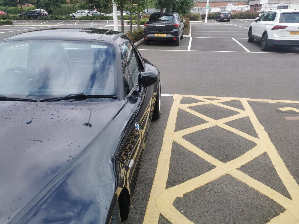

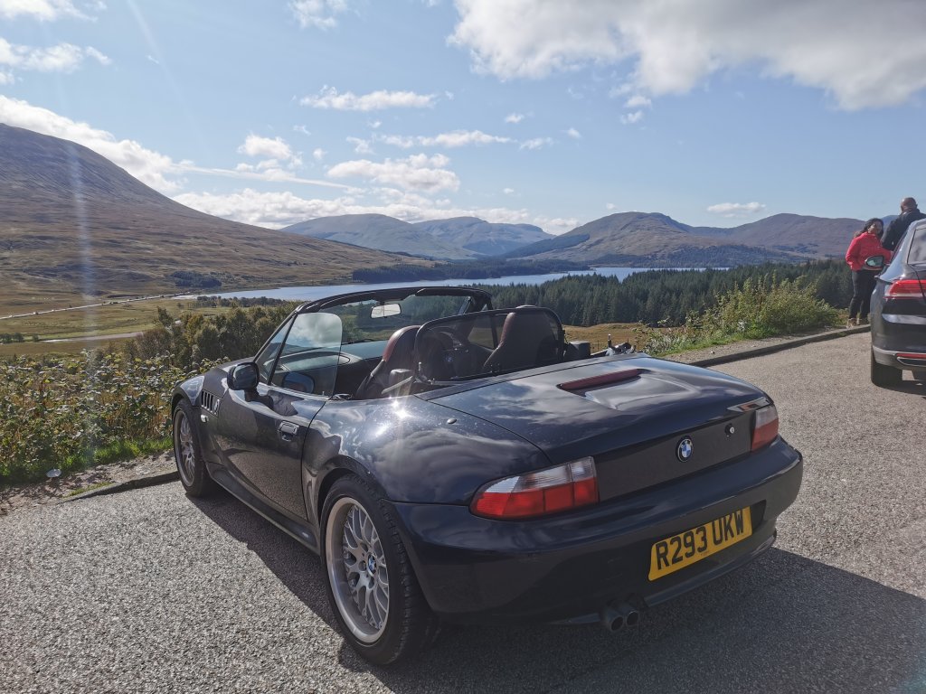

Use my car as a good example of perfect fitting wheels, no spacers, no camber plates, no shims, no stretch tyres
17x8.5j et41 and 17x9 et26 with 225/45/17 and 255/40/17
- perfection, if I do say so myself.
Remember that offset is relative to wheel width.
Front:
Maximum front is 8 inch with et35 or a derivative of this such as 8.5 et41. This is the maximum flush fitment with the arch.
