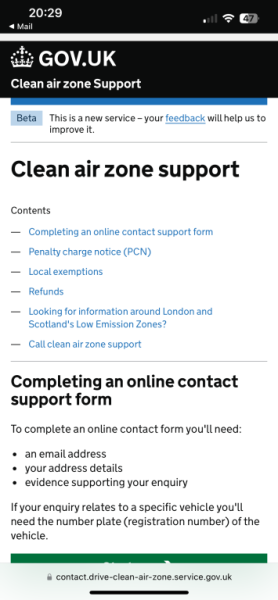

Hi Mark, TFL and regional authorities use DVLA data to check eligibility. See attached pic. I have just had a new v5 sent to me with my NOx level listed which is well under the ulez miiimum.
