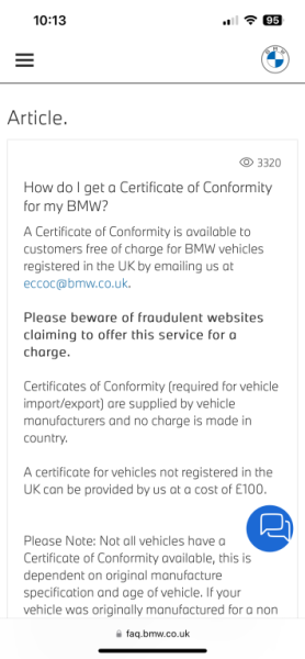

I applied to eccoc@bmw.co.uk asking for my cars conformity certificate and gave them my vin. They sent me an attachment duplicate at no fee.
								BMW I believe do not charge for a duplicate CofC. At least the didn't when I applied at the end of last year. The application is done online, I don't have the link readily available, hopefully someone on here who has applied recently can send you that. Beware websites offering a similar service for a fee.
I checked my z3 2002 2.2 on line and it said it was already exempt , which surprised me as the road tax is high.I recently requested a certificate of conformity from BMW and having received the certificate forwarded it to the DVLA. I have heard back today and my 2001 2.2i sport has been re classified as ulez exempt. Very happy and no expense on my part!
