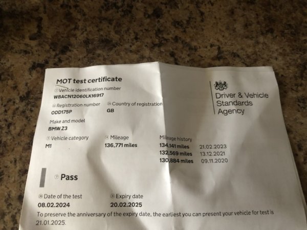

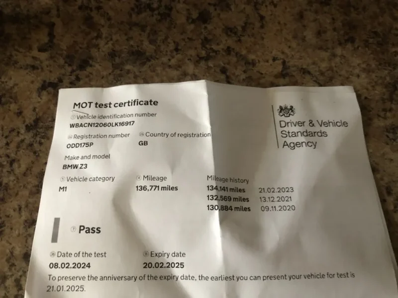

MOT pass today and no advisories, looking forward to the year to come and using it more, my aim is to get it passed 140,000 by next year!
