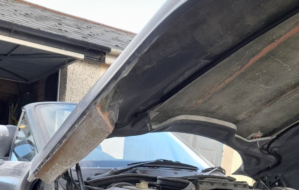

I am planning on going with the 507, however it will be 12+ weeks for delivery. I still like the idea of a working bonnet, but I know you have all looked into this option, so the fallback would be the wing/side modification.
Working bonnet. Do you mean like this?
I don't think this is hard to do. Anyone who doesn't do it has simply decided they don't need it.
I don't need it but I'll do it. It's on my ToDo list.
Bear in mind that with the bonnet open you don't have access to the fuse box or brake fluid. But the bonnet open in the above picture does look cool.

Yes that is what I mean but I want to see if there is any scope to make it a bit more practical ( wider?)
159
Pontrhydyrun - in Crow Valley
Everything is possible. Just depends how much chopping you want to do.
But a wider bonnet insert would probably look bad. ie out of proportion.
But also very difficult. Look at this picture.
You see the black tube I've got running just to the side of the bonnet insert. (That's the trunking for my wires to the front right lights.) That tube is screwed to the underside of the shell. The shell is double skinned at that point so making the bonnet insert wider even by just a couple inches would need you to cut out the double skin where my black tube is. Lot of work and, as I said, would probably look totally weird.
If your reason for making the bonnet wider would be to gain access to the brake fluid container and to the fuse box then It's not going to work. It might get access to the brake fluid but the fuse box is, kinda, behind the wheel arch so below the wheel arch bulge. You could never make the bonnet that wide.
