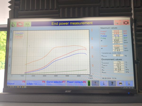

Very successful day. Nothing leaked or fell on the floor. Just finishing up some of the drivability. Will send details later but it made 550hp.
Look forward to the dyno charts..oops arrived..
Healthy numbers…
How do you manage knock detection on that engine?
I assume it wasn’t a priority for the designers as a NA engine..
Delk
Oct 9, 2018
125
Hemsby Norfolk
Z3 3.0T
Healthy numbers…
As stated the M52tu and M54 has two knock sensors already. The ECU I fitted for the turbo mods uses these two sensors to detect any and reduce timing if required. The tuners also installed a third sensor for the Dyno while they were doing their wizardry.

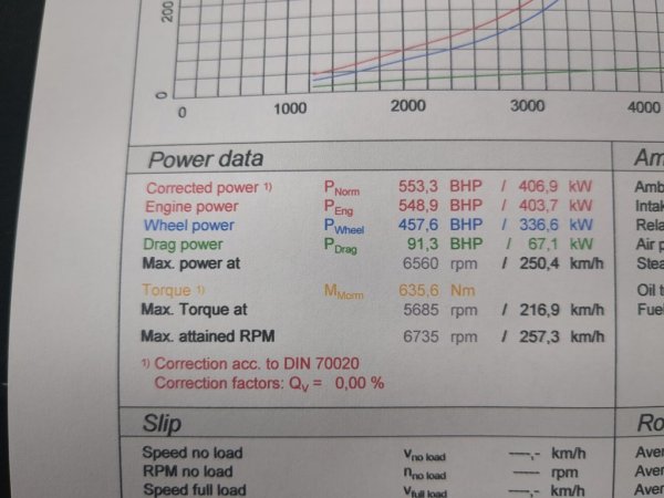

Firstly I have to say this is a garage based project and not perfect. Exhaust is still to noisy for my taste but thats the downside of getting good flow. The car runs on pump gas and is still my daily driver. It still drives like a dream and sits in traffic without any problems. But it also shifts when you press the skinny pedal.
Right now it dynoed out at 550hp at 22 psi of boost. Main limiting factor was the intake temps started to climb. Being a rhd car the exhaust manifold is a log style for space so it could be beter and a few other things but that said I am super happy how it runs. Wastegate pumpbing was a nightmare but I have it back into the exhaust so it doesnt shoot flames and sound like a jet engine. Turbo is tucked down low requiring a scavange pump for the oil but the exhaust is not sitting on the rocker cover and there are no cuts in the bonnet. The air filter is a little tricky to clean as its behind and below the right headlight but it gets cool clean air.
Today I need to change the oil and drain the radiator to add antifreeze and it will be ready for normal use. Only remaining item to fix is the fuel gauge sender. I swapped in a different fuel pump carrier I had modified to take the larger pump and the sender doesnt work. Will modify the one I took out and put it back in.
