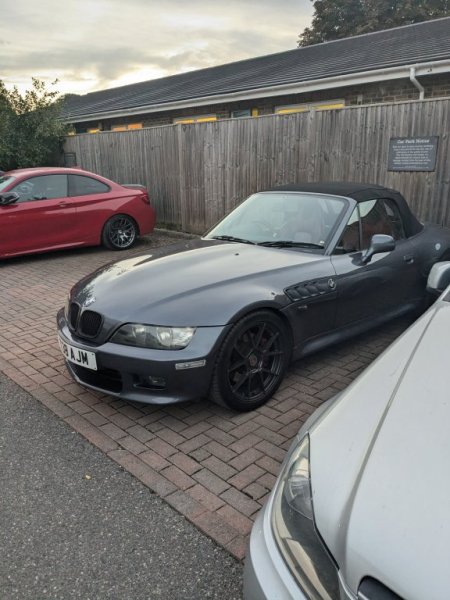

Was down at Goodwood Circuit this weekend with the Zed Owners group for the German Carfest on Saturday. Had a blast and managed to get my car on the track in the morning until I ran low on fuel. Its amazing how fast it will burn fuel at full chat for extended periods.
This was the first time I have really been able to try out the new engine. The car itself ran without fault. It is extremely fast and could easily keep up with the nicer newer cars.
There is no shortage of power and the starts involved a lot of wheel spin. I am not sure if the front straight isn’t a little loose since every time I came out of the chicane and got along side the pits it would spin the rear in third. Every where else on the track you could just ease into the throttle and it would go.
Handling and cornered extremely well. It only stepped the back out once when I messed up a hard left into a downhill section. I am running 245 fronts and 295 rears with BC coilovers. Only change I made was stiffening up the rear dampers 5 clicks. Its noticeably stiffer and a bit more then I want on the road but was an improvement on the track. The fronts showed the wear from the high speed corners and I may look at adding a few degrees of additional camber into the front.
Absolutely no complaints about the engine or turbo set up. Its spot on and power delivery was really controllable compared to the last engine. Temperture and oil pressure never fluctuated.
Only thing I would like to improve is the brakes. They worked but I started getting some disc vibration in the front when they were really hot. There was no brake fade or issues just not as crisp as I wanted when pushed really hard. Coming down the back of Goodwood the car was doing between 130 and 140 and it’s a bit unnerving looking at a right hand corner. I have 330i fronts with Brembo slotted discs 328i vented discs and callipers on the rear with EBC yellow stuff pads all around. Cant fault the set up but they can be better. Looking at some Porche 996 callipers with M3 front discs and 330i rear discs. Only thing is the handbrake on the E46 is larger then the Z3 so have to figure that out. May end up welding some custom shoes since they are 30mm larger in diameter. That’s for the future and requires more thinking.

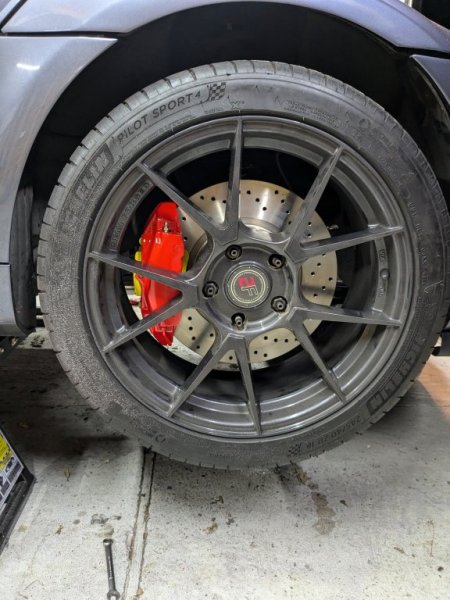

Managed to get the rear brakes fitted.
Custom adaptor brackets and hand brake shoes. I already had adaptors to fit the 328i vented discs so modified these to suit the new calipers. The hand brake is 20mm larger diameter so I made up some shoes with thicker friction material.

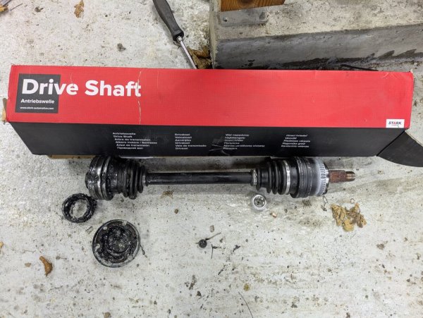

Not a happy bunny this evening after a long walk home in the wet. Broke down a few villages away so could be worse.
Not long ago. Less then a few hundred miles I swapped out the rear cv shafts just because they had a lot of miles and abused. Put in a pair that had decent recommendations. With just basic daily driving the right inner cc joint started making noise then failed all together.
Pulled the car home and the original shafts are back in.
Anyone have recommendations for good quality cv shafts?

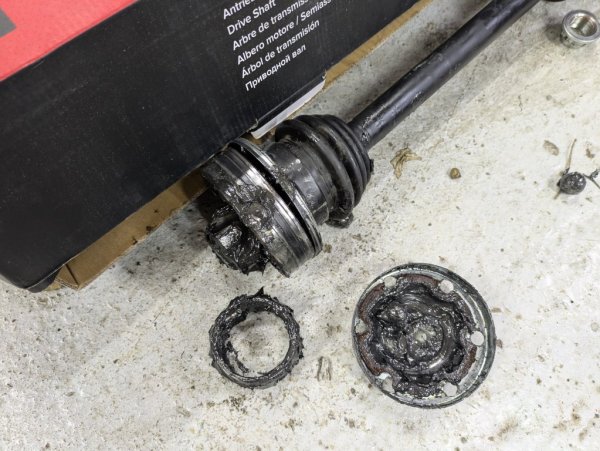

There has been no strain on these. The stock ones have taken a beating. The replacements just went in and have made a few trips around town and to work. With the state of the roads in Norfolk and the general weather this time of year any abuse would probably end up at the bottom of a ditch.
I have not cleaned it up and inspected it well but it looks as if the CV joint itself just came apart.

Next upgrade is fitting an oil cooler and painting the center top hats of the brake disc.
The Brembos upgrade hasn't seen track time yet but feel great on the road. The Mtech discs do not come coated and the middles have rusted over the winter and look crap. After all the work fitting the calipers and getting everything to work it's a bit depressing.
