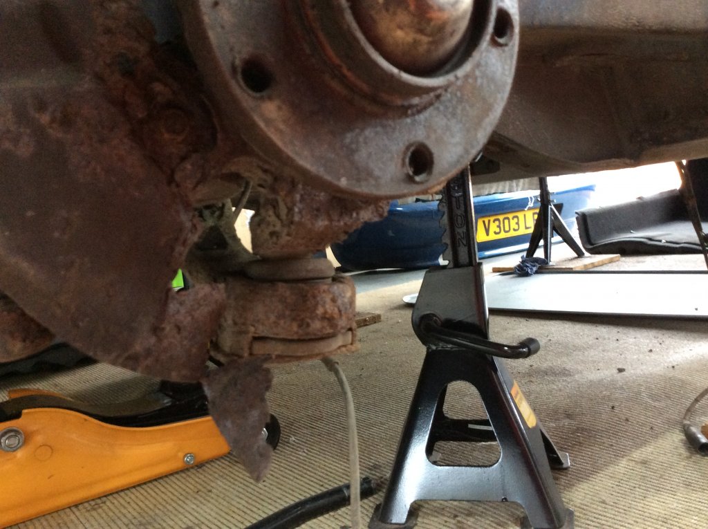

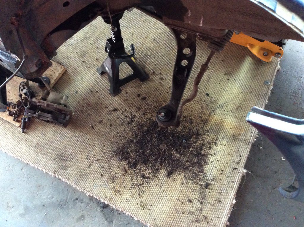

Then a bit later on got out to the garage to start stripping more stuff off......
Front end ......why? ......... Because there’s nothing left of the back end to remove :whistle:
Someone has had some of the bolts off as they were greased and came apart really easily......but others were more stubborn, but didn't stand a chance against the ‘ super sockets’.........well, all except for a ABS sensor bolt...that decided to shear off:arghh:......another task to do!!!!

Back plate is well shot as was the other side
But an hour later. ( or 10 minutes if Lee reads this)
The wish bone and track rod will be coming off later as I have replacements already.

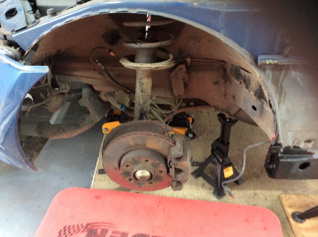

Then on to the other side.....

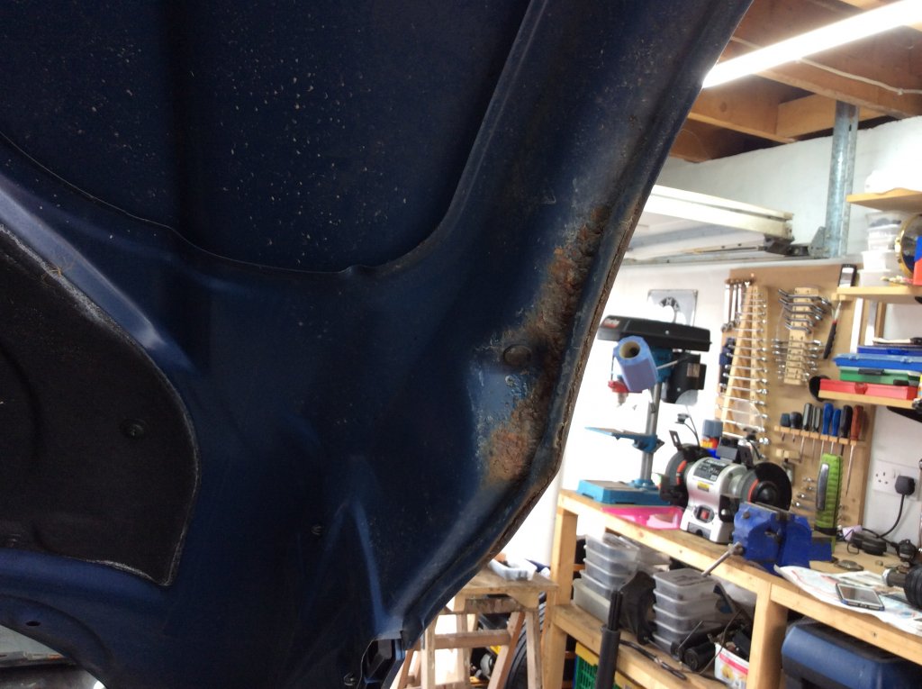

And found some nasty rust on the bonnet....both sides....:arghh: so easier to get a replacement bonnet at some stage
Hopefully Topaz blue ....but not a problem if not.
All this just so I can have one of these.......6 pot.....❤❤❤........=))
But all this work today means I can take it all up to ZSHQ tomorrow.......and get the springs off, the hubs separated , and everything can then be shot blasted and powder coated with the trailing arm.
