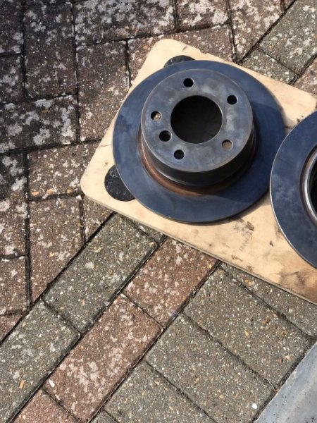

I did pick up lots of powder coated parts, and they look pristine.....going to be so nice to reassemble them all when the time comes.
