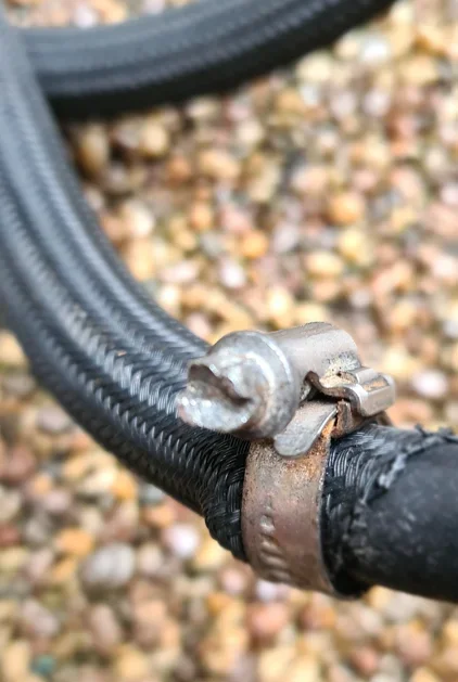

well I'm now on Christmas leave !!... so.. first day off... of course I'm going into the garaage !!
first job was to remove the old fuel pipes.... not helped by the slotted heads being ruined and the nut heads rounded off by a previous "careful" mechanic so it took half an hour to get them out...not going to fit the refreshed fuel pipes until I get the "double ear" fuel clamps, arriving at the weekend

The reason those small jubilee type clips are spoiled is because previous people haven't used a 6 point 1/4" drive sockets to turn them. A flat blade screwdriver does work, but only for so long. Any clips with a hex head needs to be turned with a socket.
Matt Barnes
Jul 18, 2020
128
Portchester, Fareham
exactly....every one of them was completely trashed. Trying to get them off from next to the engine turning about 2mm at a time was joyful
1/4 drive socketry is the thing to use.
Do they fit the new clips? If not buy one that does before you use them Matt.
I meant buy a socket that fits the clip hex heads properly before using the clips mate.;) Using those 2-ear clips is ok if you don't intend removing them in the future, but if you do then they are not what you need.
OK, just make sure it's a good fit. Mostly they are 6mm hex.
