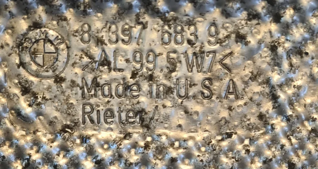

This is the number in case anyone needs it...
Same with the other two...….quite surprised to see rust., and some of the fixing holes had actually rusted through. I'm no metallurgist, but that's clearly not aluminium !
