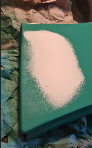

Laid down top coat over my repaired repair.... and I've finally gotten rid of the lump that was bugging me....
as before, it looks orange peely but dries dead smooth

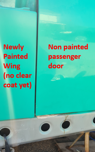

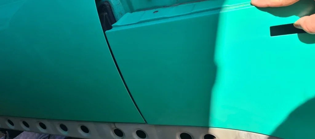

Uncovered the poor car to let it have some sun and Vitamin D =)) =)) ..... offered up the freshly painted wings and the colour match is superb !!..
the next stage is to tidy up the passenger rear quarter, paint that fully..... then 2k Clear Coat on the lot...

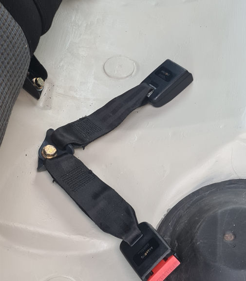

ok so it's been a while !....had to do some work on the Peugeot, fitted a new DPF, repaired a hole in the boot floor and as the seat belt brackets and bolts were rusted...you know what I did didn't you..... yep, clean, prepped and hammerited the brackets, and... zinc plated the bolts ! =))

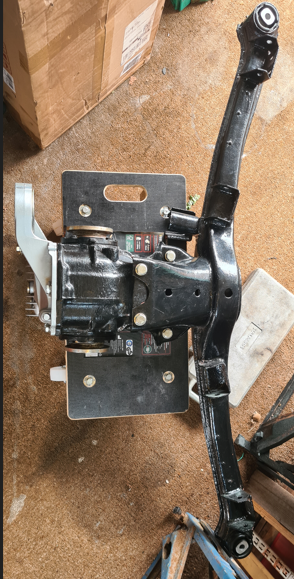

right.... first ....gather all the big bits !

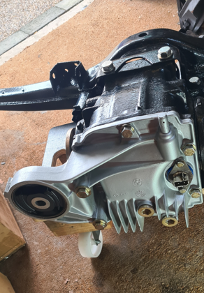

and start bolting them together !.......... and no I haven't added the Diff gasket yet... ( this is me lying on social media... ssssshh)
so far so good....... then..... I'm about to hit my first snag..... those who have done this on a trolley might guess what it is.....no scrolling for the answer and don't copy your friends answer !
ok so here is comes........ adding a Trailing Arm.... you quickly realise.... idiot... the hint centres around the washing up bowl
That's right kids !.... now I can't move it !.... yay !!! or move it under the car ! yaaaay !!!
decided on Trolley 2.0 which employed some handy planks (actually it's pallets that I broke up)
now for round 12........ on with the subframe and Trailing arms.... and ???..... yep the whole thing collapsed including the wheels..... OH how I laughed.
It actually trapped my foot, so after much swearing and pulling... I thought... "it's either my foot or the croc.... one of us has to go".....so I sacrificed my trusty croc....
I sensed another modification..... bracing !.... Trolley 3.0
now we're cooking with gas !!... so flipped it over and away we go...
so for now.... we have a rear subframe !!.....
Next steps, apart from putting on the driveshafts is to tighten and torque everything. I might wait to put the rear discs on after I've put the subframe back on the car....
