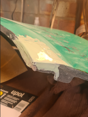

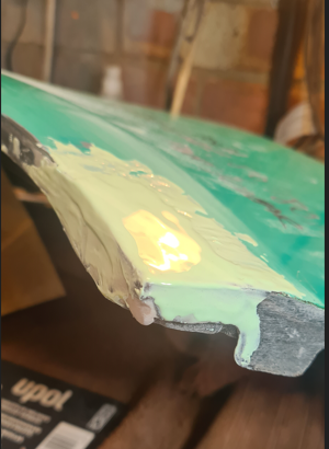

so I set to with the flap wheel and the Dremel with various grit of Dremel sanding wheels.... then I dug out my old friend POR15 and got a thin wide brush and liberally dosed both wings..... and this is POR 15 dry !... dries rock hard and shiny. I'm actually NOT going to replace that sealer, so there's now a gap between this stiffener and the wing and that's got to help drainage.
Now... onto the rear quarters..... I've always admitted any of my shortcomings , and given this bit would have been too hard for me to weld..... I cheated.... yes... I cheated.... that little patch I managed to dig out? that was put in with body filler?.. I re used it....:rolleyes::whistle::whistle:
but.. this time I fibre glassed it in... made sure the sheets were criss crossed with plenty of resin.... and I have to say, it's now absolutely rock hard. The black is the Kurust I used after grinding off all the rust inside the panel
Then it's on with the Isopon 38 and I'll let that cure before I start the sanding process....
back to the wings.... and I hit those with 80 grit in a criss cross pattern (apparently, you never sand in circles) to remove most of the POR15 residue....then I used knifing putty to fill the small craters caused by the rust
so now I wait for that to all fully cure, before I start the sanding process again...
Isopon set and rubbed down ready for the dolphin glaze stage

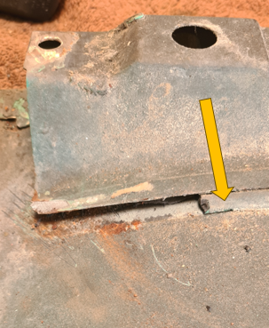

well today was laying down some paint day......... all went surprisingly well..... and then.... I had to have a visit to the confessional.... :whistle:
let me explain..... so
started with wiping down the panel... ready for paint...... that little dark area arrowed in yellow becomes important later........

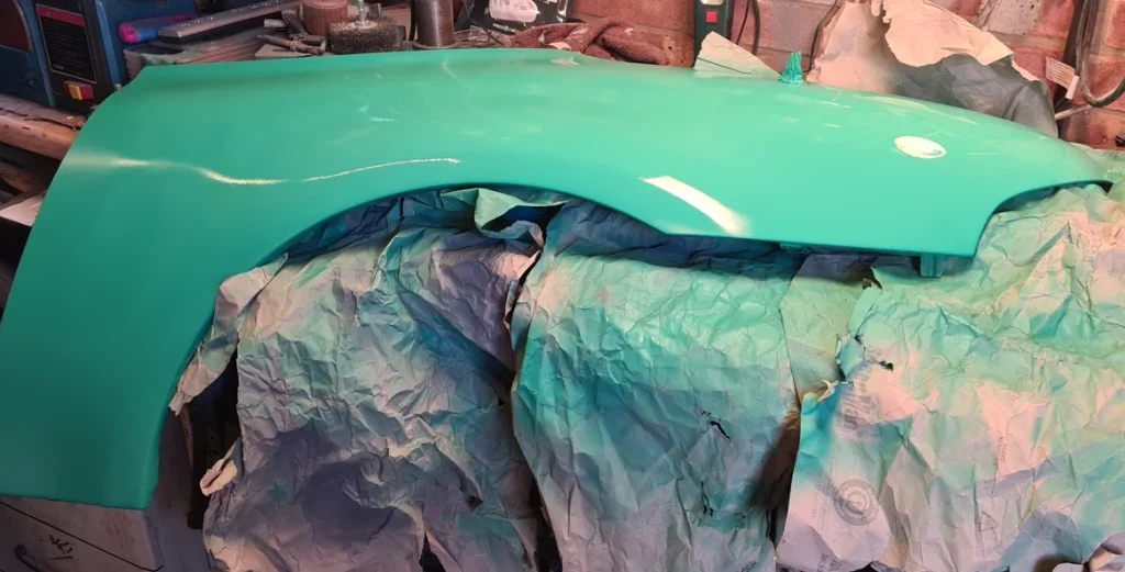

anyway... let's get some colour down
started off with two coats of fiji green and I must say I am really impressed with Tristar colour paint.... went down SO evenly
and this is how it dried......very impressed
I then did the other wing but it was very clear that what I thought was flat... was very clearly not.... so although the paint finish was fantastic... that's going to have to come off and be resanded
next up was the offside rear quarter and I have to say the colour match is excellent !!!
I actually finished just below the filler cap, even in person once the paint had flashed off you can't see the join
now..... about that yellow arrow....... time for confession........
once it had dried I noticed the dark area was actually a little clump, it didn't show when the paint was wet, but when it dried it looked like a relief map of Peru.........
so like an idiot.......I tried sanding it back......and of course because the paint hadn't fully cured, it just all balled up in lumps
in the end I had to go to extreme and get the angle grinder out and going back to bare metal.......
I've now refilled that hole with stopper.... and I'm now going to LEAVE IT !!!.... until next weekend when the paint would have fully hardened and I can try it again....

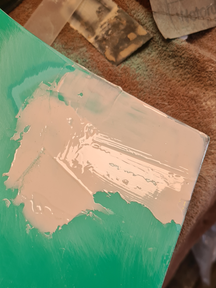

I haven't posted much progress because it would be me.... painting panels... not being happy with them, finding lumps and blemishes, rubbing it all down again and redoing it all...... three times..... GROUNDHOG DAY !!!........BUT...... we're getting there...and this time I've gone for it. Rattle canned the whole lot, and it looks a lot cleaner..........
The offside wing had a wavy ripple from the dolphin glaze, I could see in daylight ... so that all came off and redone and re primed...
while that was drying, I went for it on the nearside rear quarter, fully rattle canned....
it will dry dull while it gasses off ( as you can see on the left hand side) but 2 coats of 2K clear coat will make it pop....
Then it was back to the front wings, now fully done with two coats...you can see the dull paint that's already gassed off.
I REALLY didn't want to do the Offside rear quarter again because I'd gotten the paint just right.... but... a little lump near the bottom was really bugging me....so off it came again......
stopping filler applied
Then got it so it was mirror smooth...... combination of 60 grit pad, 80 grit pad, 1500 grit dry, then 1500 grit wet....
then on with the first layer of filler primer, I'll leave that to fully go off until tomorrow..
