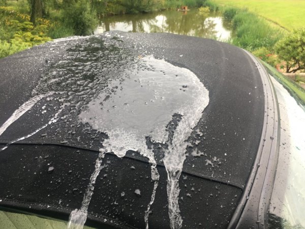

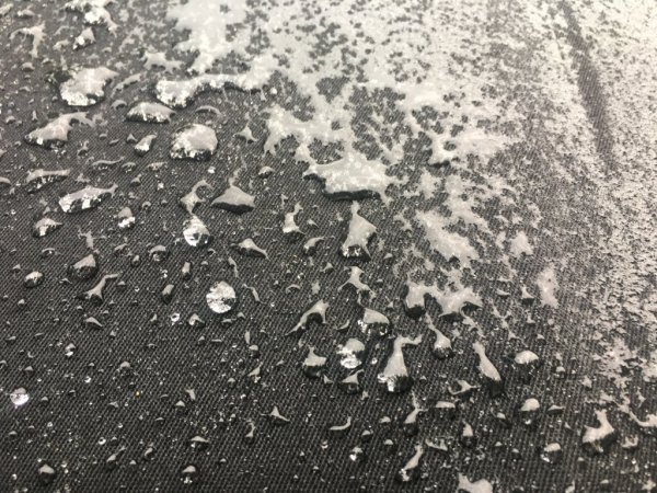

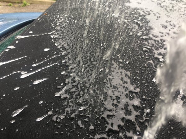

Whilst it was dry yesterday afternoon I applied some soft-top waterproofer as the rain just soaked the fabric previously. This is the stuff:
£18.75 for a 500ml bottle which just (and I mean just!) did one coat. Left to dry overnight and this morning the water beads up and runs off (pics to follow). Does that count as weight reduction?

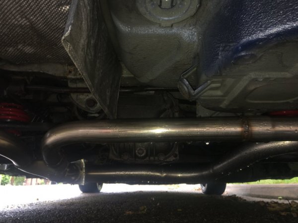

Day of the J-Pipe yesterday.
1160mm 2.25" bore J-Pipe fitted by Redhill Classics (pic to follow, raining at the mo). They teed it into the original 2.25" system and swept it around nicely to follow the custom pipe to the driver's side of the car.
Did it work?
Yep, the drone is 80% reduced, still a little there but not intrusive. I can now hear the crackle of the exhaust in the 2250-2750 rev range which was completely drowned out by the drone previously. It has also quietened down idle-2500 revs a little and 4000-4750 (must have been some harmonics there).
So my calculations were right.
Anyone with an annoying exhaust drone take note. Here is the link to the science and spreadsheet/calculator again:
View: https://www.youtube.com/watch?v=z5SY5oUTEcc
Cannot beat a bit of science.
